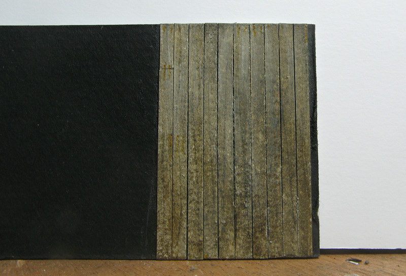

Russ, since of the main aspects of this topic is paper modelling, I thought I would share this half wall made with canson paper strips.
The paper was glued still white. Then I washed it with my water and india ink solution, followed with two somewhat randomly applied washes : burnt umber then white, reworked a few details with a bit of water and ink again, and finally used a pin and a thin brush to add hints of nails and rust (yellow oxyde oil paint).

Nobody would know it is paper from looking at that photo. Very nice artwork. -- Russ
