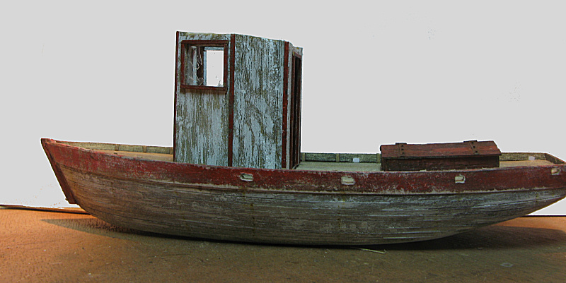

You might be interested by this picture of a ship I am currently building in O scale. The hull is covered with canson paper, the wheelhouse with wood. While there is a difference since I used distressed wood, I think that on the picture the two sidings don't appear very different.
