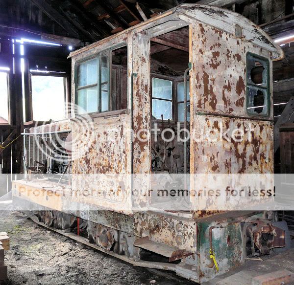

We (wife and I) were gone for a week riding the Greenbrier River Rail trail in WV. And gosh darn wouldn't you know it there was a nice truss bridge pair that required a long rest stop for examination.
I have a attached a photo of the finish. Orange and red rust with black paint still attached but peeling. Any ideas on getting this to look right in 1:48?

There are two basic ttypes of peel shown in the image...one is smooth edged and one is curling.  The smooth edged would be easy to do with the Hairspray technique.  The peel requires a bit mre discussion....I have seen this effect created to "some" degreee of believability in 1/35......however....I think you would be hard pressed to represent this effect in a realistic and scale manner in 1/48.  [it can go overscale and caricatureish in a heartbeat]....that said, I think a slight edge/lip on the paint would be enough to convey the effect....and this could be achieved using the salt technique.....it could be used in combination with the HS to vary the effect.
I would approach the painting, by painting the entire bridge in the rust finish/texture/apearance that you want showing under the flaking paint (like that in the image)....then do the HS technique......top color would then be applied in varius tones of faded black and grey.....then chipped as per the HS method.
After painting I would follow up with some pigments, and some washes. Washes need to be done very carefully so that they dont overwhelm all the joints and inside corners on the steel members.

I got an effect close to what you're looking in HO scale by using salt.
I painted the tank with cheap red primer. Then spit on the tank (honest). Sprinkle salt all over it. and let it dry.
Then a really thick coat of acrylic paint.
Then rub the salt off.
Some washes with black and brown A/I and a little bit of weathering powders adds a lot to it.

« Reply #10 on: September 08, 2010, 02:08:48 AM »
To my eye even the paint in the "after" photo looks too heavy. I suspect it would scale about an inch thick. Do you think you could achieve the same effect with a thinner coat? In other words the concept suggests promise; the execution reflects a first attempt. -- Russ

DaveInTheHat
« Reply #12 on: September 08, 2010, 10:47:48 AM »
It is thick. Like really thick. I caked it on with a brush as thick as I could get it. This was my first attempt using this process.
I did a caboose in G scale and sprayed thinned acrylic paint and it worked better.
For this I used a coat of primer as a base. Put salt on. Sprayed acrylic paint over it. Then a lighter color of red over thin coat of mineral spirits. I rubbed the salt off with a wire brush and highlighted everything with a dusting of weathering powders.
